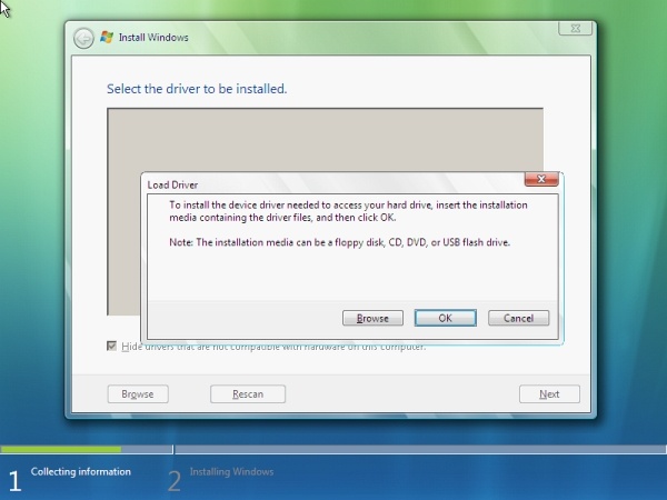

Bij Vista kun je op 'load driver' klikken en via een verkenner achtige interface bladeren naar drivers:
For those that have installed a RAID Array on Windows XP, this step will be familiar as this is where you would have to hit 'F6' and install the RAID drivers from a floppy disc. My personal system doesn't have a floppy drive as I use flash drives for all my file transfers and in Windows Vista the great folks over at Microsoft allow the drivers to be loaded from floppy, cd-rom or usb key!
