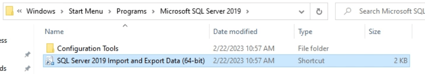

(If you already have Microsoft Access Database Engine 2016 Redistributable 64-Bit version installed, and don't want to remove it to install the 32-Bit version)
Locate and run the SQL Server 2019 Import and Export Data (64-bit) version to export your data.
Don't try to start your export from the SQL Server Management Studio, as that runs in 32-Bit
Can be found here: C:\ProgramData\Microsoft\Windows\Start Menu\Programs\Microsoft SQL Server 2019
