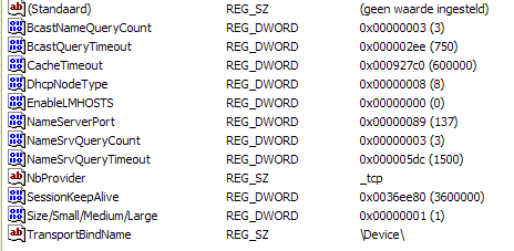

Netwerk Node settings
DHCP Node Settings
I did have a success with the following settings.
Change or add this key in the register?
[HKEY_LOCAL_MACHINE\SYSTEM\CurrentControlSet\Services\NetBT\Parameters]
"DhcpNodeType"=dword:00000008
Standard it’s set to: 00000002
This key won’t be available in some cases, but you may add it.
After restart and: IPCONFIG/ALL you will see that the connection has been changed to: Hybride.
Just for sure, export the register key to a safe place in case of security before you change the value?
Double click on this key will restore the original settings. In the same way you may alter other PC’s.
Here is a example to how it looks like.
"NbProvider"="_tcp"
"NameServerPort"=dword:00000089
"CacheTimeout"=dword:000927c0
"BcastNameQueryCount"=dword:00000003
"BcastQueryTimeout"=dword:000002ee
"NameSrvQueryCount"=dword:00000003
"NameSrvQueryTimeout"=dword:000005dc
"Size/Small/Medium/Large"=dword:00000001
"SessionKeepAlive"=dword:0036ee80
"TransportBindName"="\\Device\\"
"EnableLMHOSTS"=dword:00000000
